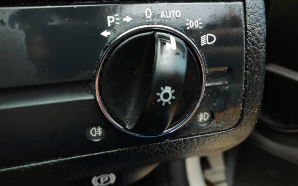

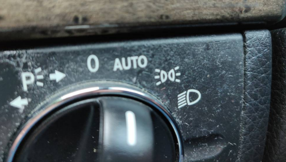

I have just acquired my s211 Advantgarde S and the vehicle is in perfect shape, with an almost pristine appearance.
However, the headlight switch panel was subpar as it seemed to be a low-quality plastic object reminiscent of a bargain store toy.

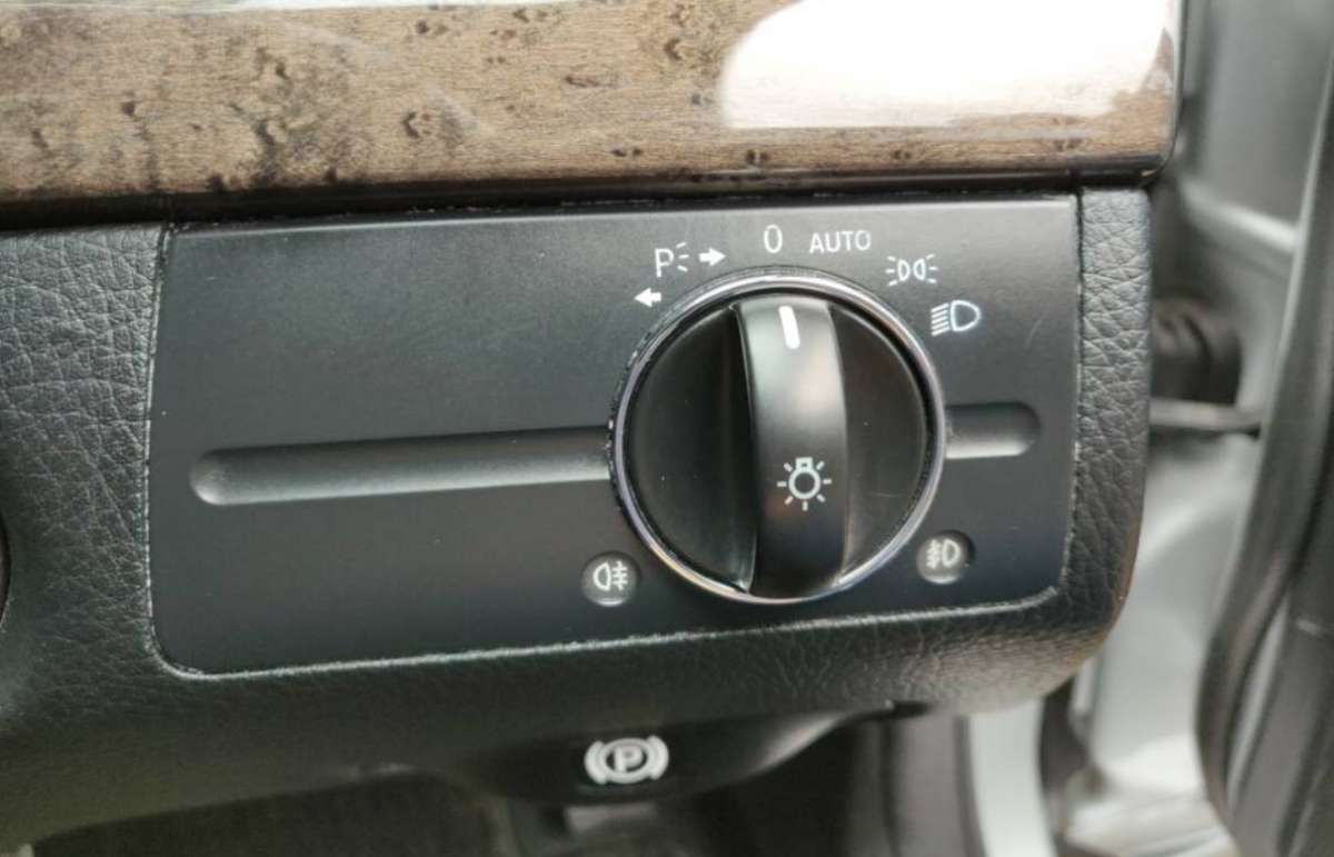

3. Concluded the process by using CarPro Perl to get a much improved medium shine appearance.
Completed!
image.thumb.png.9c07c750ef5e1c05d9fbd2bd4f9f1c55.pngimage.thumb.png.a7b7080fd37dbaecace8d337f89c544b.png
image.thumb.png.441c063f8c112793641155863fdd56b3.pngimage.thumb.png.c94f2699d11c2669010badeeea23e95c.png

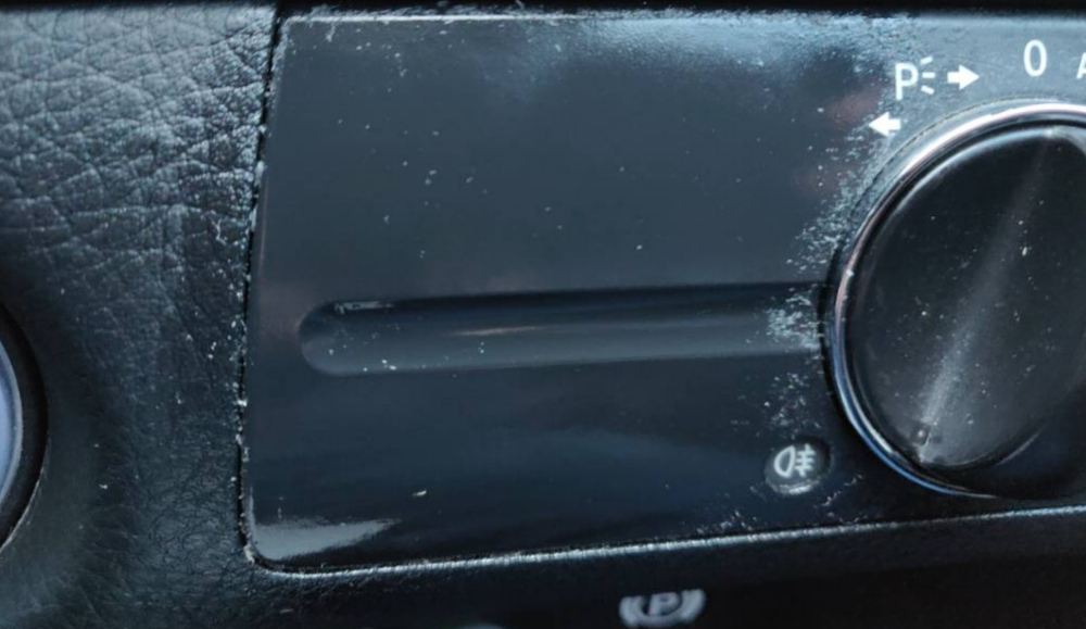

I had to do the same action on the multifunction buttons of my S210's steering wheel. Additionally, because the headlight switch panel of the S211 successor is in a deteriorated state, it seems that I will have to repeat the same process. The rubberized coating used by MB does not seem to be very durable. The panel of the S211 was initially satisfactory, but due to excessive enthusiasm during cleaning, I inadvertently created a conspicuous bare spot that is quite noticeable.
One important point to note is that I used Isopropyl Alcohol as an initial softening agent, then removing the softened coating with my fingernail, and concluding the process with a thorough cleaning using GooGone.
I will maintain the object in its original state and ensure its cleanliness using the CarPro product until the effects of the transfer have faded, at which point I will proceed to replace the component.
