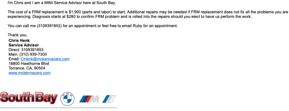

Uneripty Posted February 24, 2024 Share Posted February 24, 2024 I inquired about the price of replacing the FRM at South Bay BMW. Painful! Link to comment Share on other sites More sharing options...
Uneripty Posted February 24, 2024 Share Posted February 24, 2024 Link to comment Share on other sites More sharing options...
