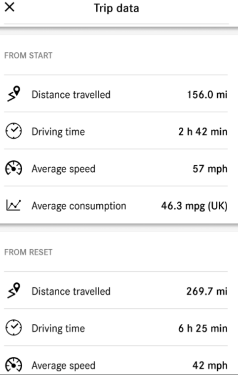

I would request a longer duration for the test drive and reset the trip computer to accurately determine the miles per gallon (mpg) achieved. Additionally, it may be prudent to inquire about the possibility of arranging a test drive for a petrol estate vehicle that closely matches the specifications you want.
