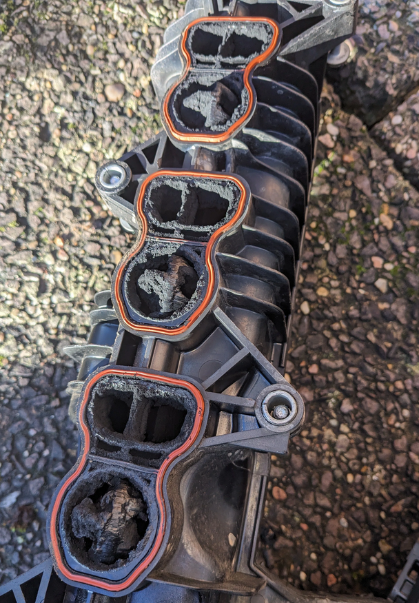

The car was experiencing vibrations and emitting smoke upon starting. Consistently involves extended journeys on highways. I took a risk and purchased an EGR valve and intake manifold of OEM grade.Less than 200 pounds. Endured a gruelling six-hour process to install them. However, the removal of the mentioned item clarified the cause of the engine's erratic performance. The vehicle has completed a total mileage of 132,000 kilometres, which has resulted in an unforeseen issue.
Viscous sludge. Although it was challenging, I managed to fix the issue temporarily, despite breaking the dipstick and coolant sensor plug. I am unable to fully comprehend the amount of debris present in my manifold. Moreover, it should be noted that the individual has attempted the customary additives. Financially imprudent. BMW requested a payment of 1500 pounds. Completed in 180. The current performance of the system is excellent. Do not make the assumption that n57 poor cold starts are caused by faulty glow plugs. This is the undesirable material found in intakes. The issue lies in the fact that replacing the components is quite difficult and challenging. Sensor plugs and other components were confiscated.

After covering a distance of over 50,000 miles, the intake system is now experiencing accumulation of debris due to the recirculation of impurities into the input manifold. Consequently, I am curious about the current level of burn efficiency. The situation is deteriorating rapidly.

Moreover, the sensors are prone to immediate malfunction upon attempting their removal, resulting in significant inconvenience. And the foolish dipstick mounting bolt. What on earth! I discovered it and set it free, but, I accidentally damaged the dipstick tube when attempting to remove the whole assembly. The secondary Exhaust Gas Recirculation (EGR) system prevents any further efforts to remove the manifold. Upon reflection, I contemplated either permanently disabling the automobile or removing it with the expectation of resolving the issue. Yes, I did, but it was for a faulty coolant temperature twin plug. I had to repair a damaged plug and apply silicone to the other plugs where the spring clip had detached. With the sole purpose of deceiving the Green Brigade. Develop a dependable engine and disregard any other distractions.
It is unusual that both my E46 330d and my 640d had quite clean manifolds. Both vehicles had their EGR systems removed, however the 640d had this modification done at 79,000 miles and the condition of the manifold was inspected at 83,000 miles.
