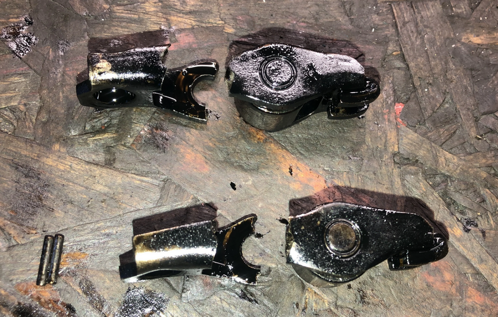

Kenjibb Posted January 23, 2024 Share Posted January 23, 2024 With a mileage of 99,000, it would be advisable to replace the chains to prevent any potential damage if they were to fail. I have obtained another item that now has Link to comment Share on other sites More sharing options...
Kenjibb Posted January 23, 2024 Share Posted January 23, 2024 Link to comment Share on other sites More sharing options...
