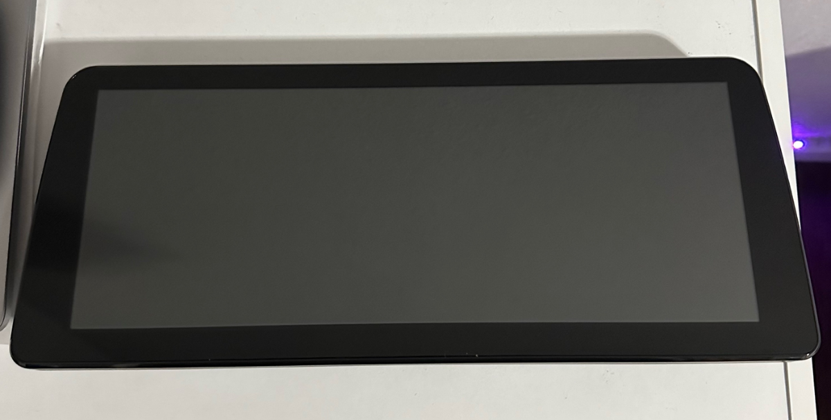

I was likewise in search of a 12-inch display and I had difficulty in finding a well-established and dependable touch screen for Android. Nevertheless, Seicane offers a 12" android display, prompting me to make the decision to buy it.

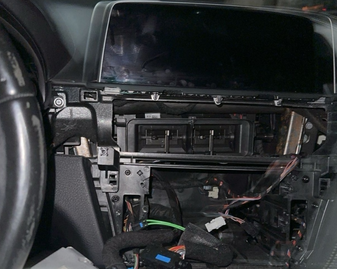

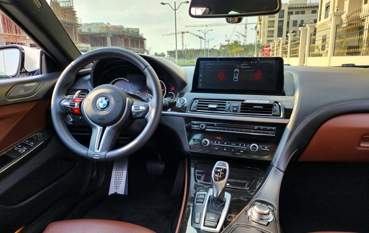

I will provide a more comprehensive assessment at a later time, since I am now occupied but wanted to share this information promptly. I successfully mounted the 12-inch display and it works well without any significant problems.

After doing a thorough comparison of the two systems, I ultimately chose the Nunoo over the Seicane because to the much superior performance of the Qualcomm Snapdragon665/625, in contrast to the RK3066 1.6GHz Cortex A9 Dual-core. Despite the fact that the price difference has increased after my purchase. The installation process was problem-free and straightforward. The system is essentially plug-and-play, with the exception of a few minor features.

Overall, it was a significant improvement, particularly considering the issue with the peeling anti-glare on my screen. Additionally, I had been desiring an update to use android auto. When playing music videos using USB, it is important to note that the video seems much brighter and more prominent at nighttime.
