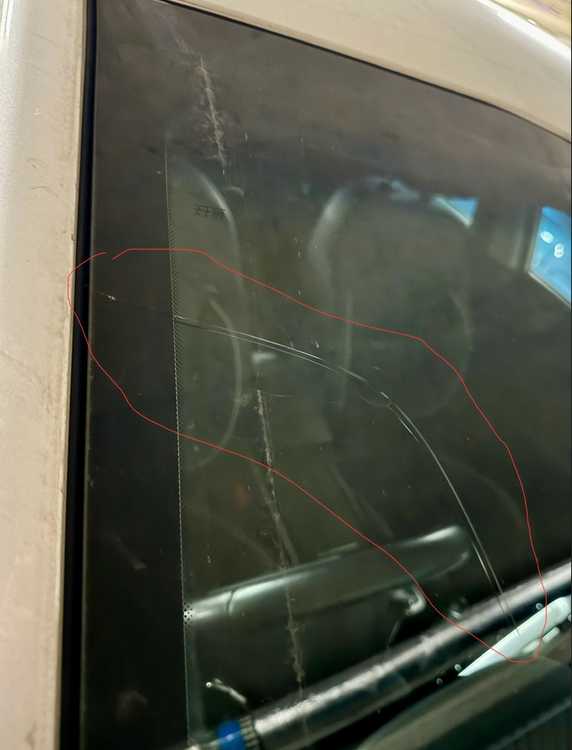

This morning, I discovered a fracture in the glass of my MY20 vehicle, which I marked with red colour. The damage should be located on the left side of the photo.
I want to know whether the Kia warranty would be impacted if I get my vehicle repaired by Autoglass instead of Kia.
Please provide guidance on my next course of action. Thank you very much.

Your warranty will remain unaffected.
Make sure that the person handling your vehicle is able to readjust the rain sensor located near the mirror.

After hearing about your experience, I contacted Autoglass this morning. They informed me that they only provide OEM glass unless I specifically ask for a Kia genuine one, which comes at a higher price and takes longer to get. I am considering cancelling the Autoglass appointment and opting to see Kia directly instead.

Thank you for the detailed information. Recalibration is a problem for me as well, especially since my MY20 vehicle has a camera located at the top of the glass to enable the automobile detecting features.
