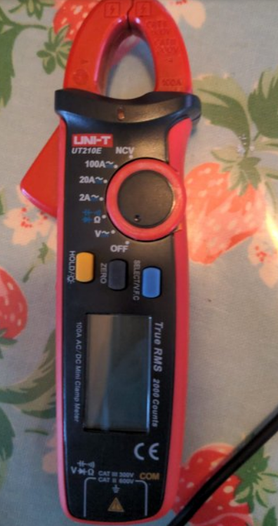

OmahaKnot Posted January 29, 2024 Author Share Posted January 29, 2024 Hello, I appreciate your response. I have purchased the NGK non-resistor spark plugs that have been highly recommended on this platform. Additionally, I own magnecore blue high-tension (HT) leads that are still covered by warranty. I reverted back to using resistor plugs in order to see whether there was any effect, but, the issues remained same. Consequently, I reinstalled the non-resistor plugs. I own a multimeter, but I am uncertain about its capability to measure duty cycle. Observe the enclosed image. Furthermore, during a test conducted at idle in a neutral state, I saw that when I accelerate in my usual manner, the engine tends to stall. However, when I gradually and slowly increase the acceleration, the engine works smoothly without any stalling issues. Is there a problem with the fuel/air mixture? Link to comment Share on other sites More sharing options...
