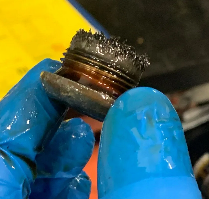

The mileage on my 2012 V10 with the 6 speed manual is around 45,000 miles. It serves as my everyday vehicle while I am at home. Engaging the third gear has consistently proven to be rather challenging, and while it has never failed to engage, the shifter gives the impression of potential slippage. The technician has recommended replacing the clutch, which I will go with. However, I first began the process by changing the gearbox fluid. The magnet attached to the drain plug contains a significant amount of metallic material. It seems to be a process of rebuilding or replacing a gearbox. I have attempted to locate a replacement gearbox but have been unable. I have also had difficulties in locating a shop to repair the engine on my vehicle. I am located in the Phoenix Valley. Do you have any suggestions for a reliable and trustworthy company that can reconstruct this gearbox or a source where I can get a reconstructed one for replacement? Thank you in advance, everyone!

Metal filings are often seen due to the interaction between metal surfaces, resulting in the formation of metal filings.
1. The interlocking of the syncros and speed gears. 2. The clutch plate material derived from the LSD.

that is a substantial amount of metal filings, correct? I get that the magnet is intended to gather them in order to prevent their circulation, and although some are anticipated, it seems to be excessive. I am uncertain.
