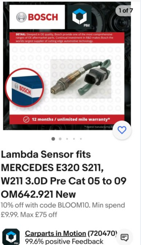

I have recently verified. MB Newcastle offers the EBPS on eBay at a price of £66.
The price range for MB O2 sensors is often between £200-300 or more. However, I would recommend purchasing a Bosch O2 sensor from eBay, since they are available for only £84.
I just purchased a downstream oxygen sensor for the C200 model from Autodoc for a total cost of £24 plus value-added tax (VAT).
The brand was Ridex. The replacement was accurate.
The process of changing takes around 30 minutes.
Thank you for your assistance, Sir! 👍👍
Do you have the component number readily available? Is it reasonable to assume that the sensor is same for both the 280 and 320 versions? The length of the cable is 560mm.
