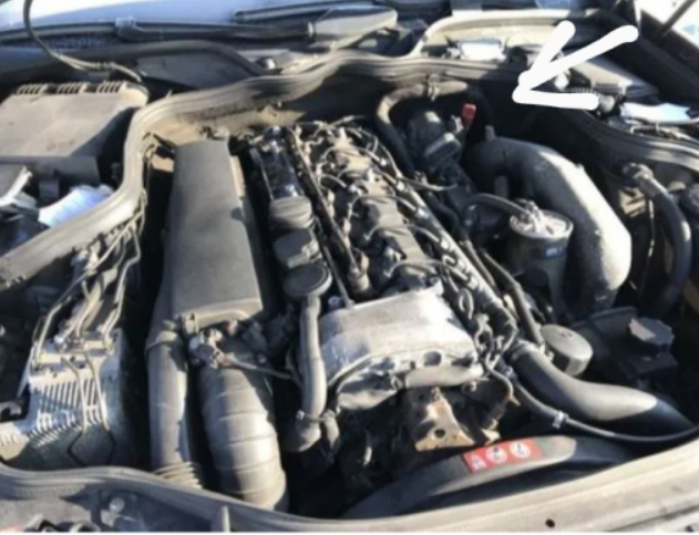

Anabroo Posted February 28, 2024 Share Posted February 28, 2024 You may get a dipstick for your CLK from Ebay. The WIS provides details on the specific measurements in millimetres for the high and low marks on the dipstick for your vehicle. Simply indicate the item from eBay appropriately and that will enough. Despite using electronic measurement, I saw that the reading never dropped below 2.4 litres even after all the oil was removed, indicating that it should have shown as empty. Even when overfilled, it never exceeded 6.8 litres. Using a suction pump enabled me to conduct several experiments, leading me to the conclusion that a dipstick is unbeatable. Cannot see why Mercedes believed they had superior knowledge! Link to comment Share on other sites More sharing options...
WordSnoop Posted February 28, 2024 Author Share Posted February 28, 2024 Yes, using a dipstick is a wonderful idea, but accessing it requires removing half of the engine cover, and it may be unclear which one is the proper dipstick. I concur with the statement on electronic measuring. My fuel gauge showed 2.4 litres when it was believed to be empty. Link to comment Share on other sites More sharing options...
BizarreBleak Posted February 28, 2024 Share Posted February 28, 2024 Link to comment Share on other sites More sharing options...
