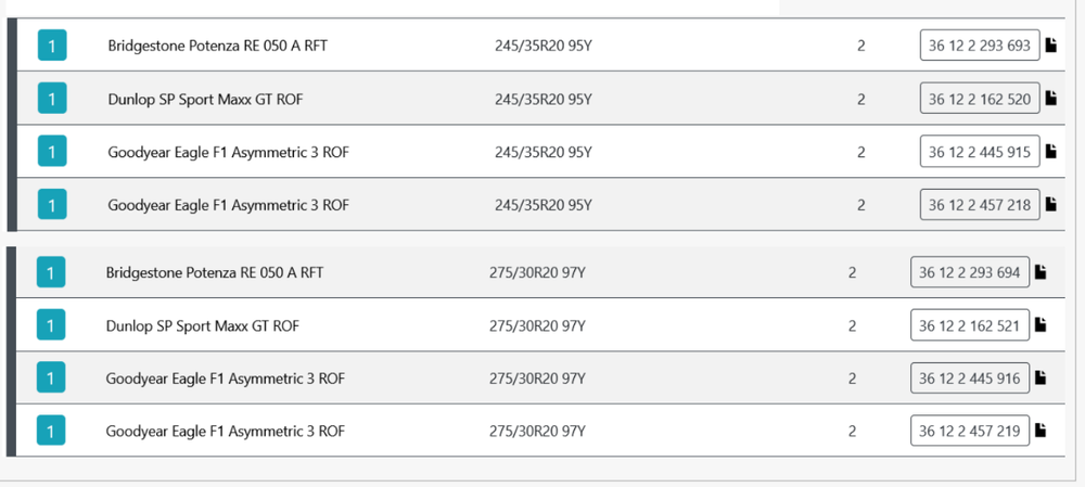

Recommendations for run-flat summer tyres for type 373 wheels in 20 inches. Refer to the wheel specifications shown below.
You may find the BMW component numbers and specifications on the backside of the wheel's spokes by dismounting the wheels. That is an alternative method to confirm the size you own.
The component numbers and specifications for the wheels may be seen in the pictures shown above from the part database. An example of the rear wheel's component numbers and wheel specifications may be seen on the back side of the spokes in the pictures below. The final 7 digits of the BMW part number are being utilised instead of the whole 11-digit part numbers. This is typical.Sometimes the whole 11 digits are provided, while other times just the last 7 digits are offered.
