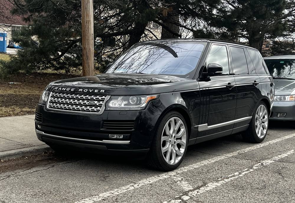

CrawlerTagz Posted February 20, 2024 Share Posted February 20, 2024 I just purchased a 2016 TD6 with 68,000 miles on it. The engines have a pleasing sound and operate really well. I want to maintain the current situation to the best of my ability. I intend to change my oil every 3,000 to 5,000 miles. I am willing to pay more for my piece of mind. What kind of oil and filter do you use? Your feedback is much appreciated. I am researching the differences between 5w30 and 5w40 oils, as well as the distinctions between c1 and c2 specifications. Link to comment Share on other sites More sharing options...
