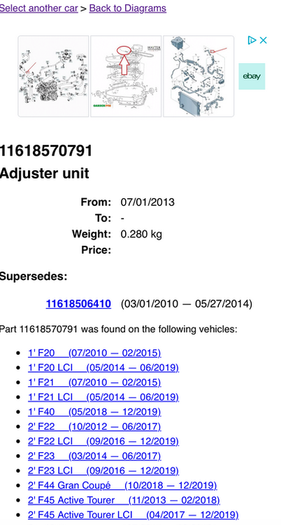

tr4s Posted March 18, 2024 Author Share Posted March 18, 2024 Thank you for your assistance. However, I realised that my explanation was incorrect. The little plastic arm that attaches to the rod of the swirl flaps is barely visible in the picture... Pardon me, but is the diminutive arm or bracket located at the extremity of that? If that is really the case, do they also provide a V6 version? Link to comment Share on other sites More sharing options...

Finestey Posted March 18, 2024 Share Posted March 18, 2024 Therefore, the motor you need is the one that is available for purchase separately. Link to comment Share on other sites More sharing options...

Wordcar Posted March 18, 2024 Share Posted March 18, 2024 The actuator seems satisfactory to me, albeit its visibility in the photo is limited. As far as I recall, it has just a single arm that may be inserted into the linkage on the manifold. The image seems to depict the linkage arm remaining attached to the actuator. It should just detach. The manifold was originally cleaned, however, further modifications were required to the actuator in order to establish a new stop point and address the wear in the linkage. The device functioned and lasted for around one year until the malfunction resurfaced, prompting me to choose for a replacement. Introducing a novel one. Thank you. Link to comment Share on other sites More sharing options...
tr4s Posted March 18, 2024 Author Share Posted March 18, 2024 The object fractured into three fragments, exhibiting a high degree of fragility and evidently remaining affixed to the vehicle till the present day. I severely taxed my patience by disassembling everything to address the issue, without breaking a single clip, and then this. As you said, investing in a new item results in reduced cleaning requirements and the assurance that it is completely new. It is essential to use caution while affixing the motor to the newly introduced intake manifold. Link to comment Share on other sites More sharing options...
