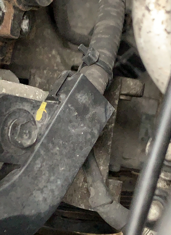

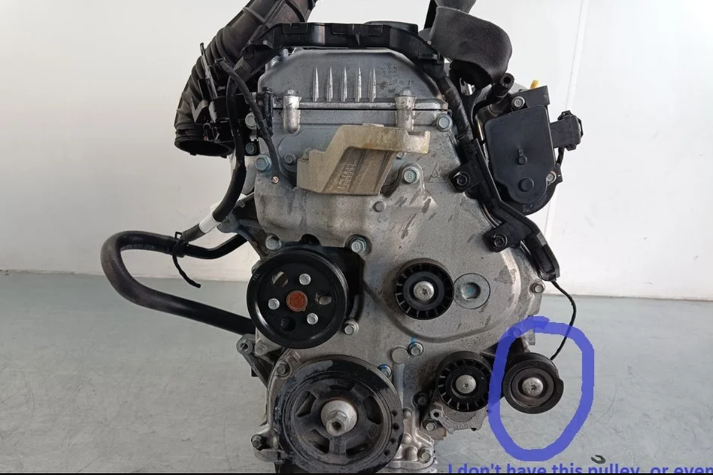

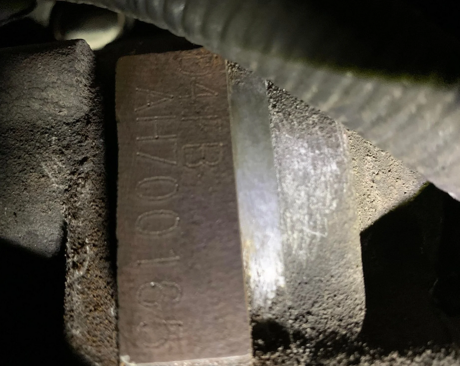

Angurita Posted February 7, 2024 Share Posted February 7, 2024 Greetings, everybody. I acquired a 12-plate Kia Venga 1.6 Crdi (85KW as shown in the logbook) at an auction. The serpentine belt emitted a cacophonous sound, and the air conditioning system was non-functional. I brought the automobile to a garage where the expert informed me that the current belt fitted on the vehicle is incorrect and has been installed in the other direction. Additionally, the air conditioning system is not even linked. He attempted to purchase tensioners and the belt from the nearby Kia dealership, but the package they sent based on the vehicle's registration number was entirely different to the engine installed in the car. The garage diligently sent films and images to Kia, but unfortunately, they could not achieve any success. Subsequently, we discovered an orange painting on the engine, indicating that it is a replacement engine sourced from a scrapyard. However, the only drawback is that the new engine does not match the original engine precisely. The front pulley is entirely absent, and the metal bracket that secures the pulley is non-existent. After cleaning the engine number, I discovered that the engine code (D4FB) matches the one recorded in the log book. However, I noticed that the physical appearance of the engine is distinct from what I seen online and elsewhere. After reaching out to both Kia and Hyundai, both of which use the same engine, I received confirmation from Hyundai's customer care that the engine in question was not allocated to a Hyundai vehicle. However, the representatives from Kia were unable to provide me with such information. This was disappointing. I have a buddy residing in a different nation who has verified via the engine number that this particular engine was intended to be sourced from a Kia, although manufactured prior to the year 2011. I was fully committed to it. I need information on the specific belt that I should purchase. Kindly refer to the included images. Appreciation is extended for your kind gesture. Link to comment Share on other sites More sharing options...
Angurita Posted February 7, 2024 Author Share Posted February 7, 2024 Link to comment Share on other sites More sharing options...
bellox Posted February 7, 2024 Share Posted February 7, 2024 According to the information on Wikipedia, the Venga is equipped with the engine mentioned. However, it should be noted that the YN listed is a petrol engine, not a diesel engine.The engine located just under my words is the diesel engine. The engine has a displacement of 1.6 litres and is identified as D4FB. The 1.6 L (1,582 cc) U diesel engine, sometimes referred to as D4FB, is manufactured in the Žilina Kia plant in Slovakia. It is an enlarged variant of the 1.5 litres (1,493 cc) U series engine, with a bore size of 77.2 mm (3.04 in) compared to the original 75 mm (2.95 in). In 2009, the engine underwent improvements and was upgraded to the 1.6 U2 version. This new version had a different displacement and was capable of producing 126 horsepower (94 kilowatts; 128 metric horsepower) and 195 pound-feet (264 Newton-meters) of torque.The user's text is "[2]". Specifications of the engine Engine capacity: 1.6 litres (1,582 cubic centimetres) The bore and stroke dimensions of the engine are 77.2 mm by 84.5 mm (3.04 in by 3.33 in). The compression ratio is 17.3 to 1. Power options include 90 PS (66 kW; 89 hp), 115 PS (85 kW; 113 hp), or 128 PS (94 kW; 126 hp). The torque values for this item are 24 kg⋅m (235 N⋅m; 174 lbf⋅ft), 26 kg⋅m (255 N⋅m; 188 lbf⋅ft), or 27 kg⋅m (265 N⋅m; 195 lbf⋅ft). Software programmes or tools used for specific purposes or tasks. The Hyundai Accent was produced from 2010 until 2020. The Hyundai Creta (GS) was produced from 2014 to 2020. The Hyundai Elantra (AD) was produced from 2015 to 2020. The Hyundai Kona (OS) was produced from 2017 to 2020. The Hyundai i30 was produced from 2007 until 2019. The Hyundai ix20 (JC) was produced from 2010 to 2019. The Kia Carens (UN) was produced from 2006 to 2013. The Kia Cee'd/Ceed was produced from 2006 to 2018. The Kia Forte/Cerato was produced from 2008 to 2018. The Kia Seltos has been in production since 2019. The Kia Soul was produced from 2008 until 2019. The Kia Stonic was produced from 2017 to 2018. The Kia Venga (YN) was produced from 2009 to 2019. Link to comment Share on other sites More sharing options...

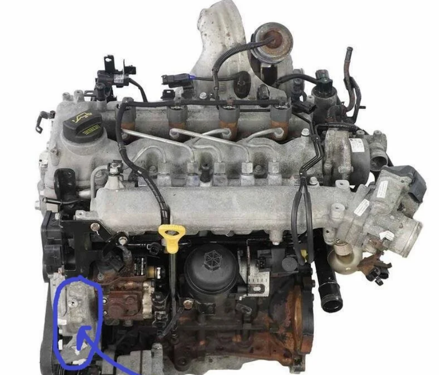

bellox Posted February 7, 2024 Share Posted February 7, 2024 This is the engine of the Hyundai i30. Does it bear resemblance to yours?To access further perspectives of this engine, please choose the image of the larger engine. https://www.b-parts.com/auto-parts/engine-transmission/engine-hyundai-i30-estate-fd-16-crdi-2007-2008-2009-2010-2011-2012-4878906 Link to comment Share on other sites More sharing options...

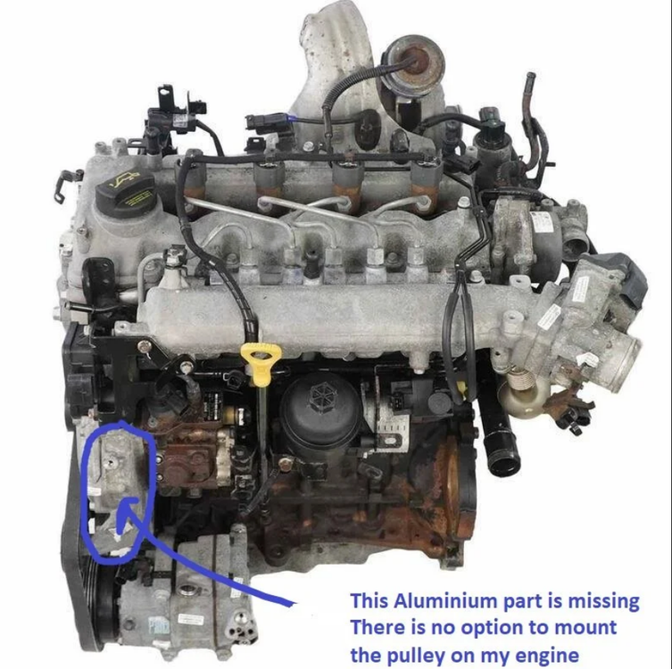

Angurita Posted February 7, 2024 Author Share Posted February 7, 2024 Greetings. I appreciate your diligence. The bolt receptacle on my engine is missing, namely the aluminium support that is an integral component of the exposed engine. Link to comment Share on other sites More sharing options...
SlayNeo Posted February 7, 2024 Share Posted February 7, 2024 Based on appearances, it seems that the pulley and the aluminium component are intended for the air conditioning system. Based on the current configuration, it seems that not only has an engine replacement occurred, but your air conditioning system is also absent, since the compressor would typically be installed in that location. Link to comment Share on other sites More sharing options...
